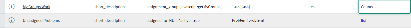

1) If a user removes My Groups Work from the ITIL homepage, where do you find it to add it back? I can't find it in the Add Content frame.
2) I created a 2nd gauge similar to My Groups Work with an additional filter. But again, I can't find it to add to the ITIL homepage.

My Groups work is a gauge whose type is 'list' by default. (the type 'list' option is now deprecated.)
I just changed the type to an option - 'count' and the gauge is now selectable

Did it still work for you then? Mine shows up empty then instead of listing the items. And doesn't look like I can go back to the list type.
