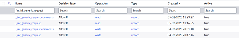

How to allow snc_internal users who are on a ticket Watchlists to comment on Additional comments in Service Portal? Which Role should I give them? ITIL ?
These users do not have any other role, apart from snc_internal.
I am not sure. Please tell. Screenshot below.

Resolved: Instead of giving ITIL role to snc_internal users (as this will have a financial impact), therefore I resolved the issue with ACLs.
Got the solution with the below link:
Solved: How to allow users on watch list to post additiona... - Page 3 - ServiceNow Community
Just add snc_internal role to all my 4 custom ACLs and remaining was the same from above link.
First you need to give Read access and then Write access at table level and Field level. (Screenshot attached below)
1) table.None (Read operation) - Just added snc_internal role and no conditions.
2) table.None (Write operation) - Just added snc_internal role and 1 watchlist and 2 state field conditions.
3) table.Additonal comments (Read operation) - Just added snc_internal role and 1 watchlist field condition.
4) table.Additonal comments (Write operation) - Just added snc_internal role and 1 watchlist field condition.

I believe I mentioned the same to you to use ACLs for those fields READ and WRITE.
I could see you marked your own response as correct.

Point to note, if you start to adding roles to users, this could (and most likely) have a financial impact to the instance.
ACL solution would be the way to go here.

Will you please tell how should I create an ACL? What conditions should I mention there for snc_internal role?
