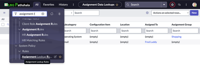

You can try using script tracer. Start script tracer and then submit the record producer and then stop. (search for script tracer in application navigator)
You can also look for assignment rules in application navigator.

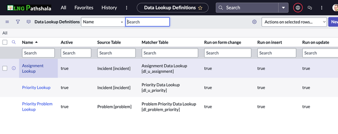

Hi @Mk_snow
In this case, you can check the Assignment Rule / Data lookup or the On-Call Schedule. Also, verify if you are setting any group directly in the RP code itself.

03-25-2025 01:54 PM
Hi @Mk_snow
We can see that RP is an interface, but at the end, the incident gets created in Native View, where the assignment rule works. Give it a try and share your feedback.
