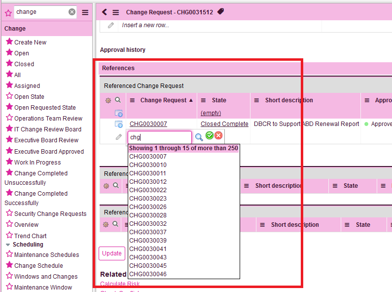

Hello Community,
I have just created a m2m list that references other change requests, requests, and requests items to the change_request table.
I am able to add CR records in the many-to-many list on the chagne_request table as admin
but when i try to add it as another user they are not able to add records to the list.
I am trying to configure the security for the list to match another list on the change_request table that they already have access to not finding any type of correlation.

not sure if there is an area that I am supposed to configure to match the list they do have rights to.

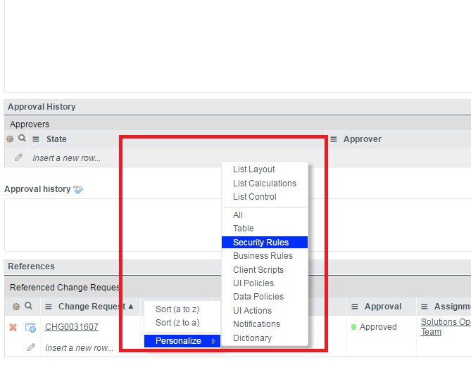

Hello everyone,
I have found the solution to this one.
I went to the table of the many to many list i created
I then created the following rules
and then BAM!
Thanks for all your help chuck.
Have a great weekend.
also you have to be in security mode:
