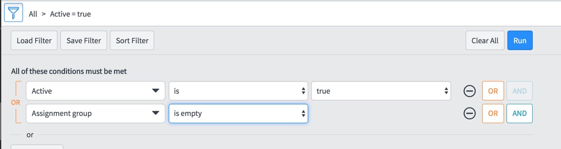

Don't forget, you can always build your query using the list builder and then right click on the breadcrumb and select Copy Query.
