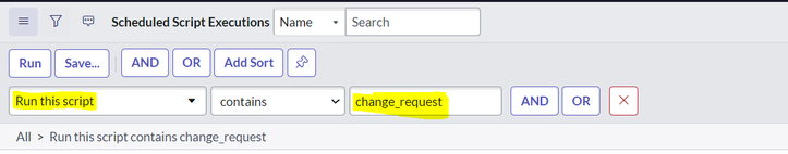

Open the list of Scheduled Script Execution [sysauto_script] table.
Add below condition in the filter to see all the Scheduled Jobs which is have 'change_request' in script:
From the Filtered records, find out the Scheduled Job you are looking for.

suvro
Search the scheduled job table with name *change
See how many scheduled jobs are written for change management. One of them is your culprit. Or you can use code search facility in servicenow studio search in all applications to find any specific keyword in codes

ak49
Hi Raycallan,
I got the solution and  Anubhav has provided me.
