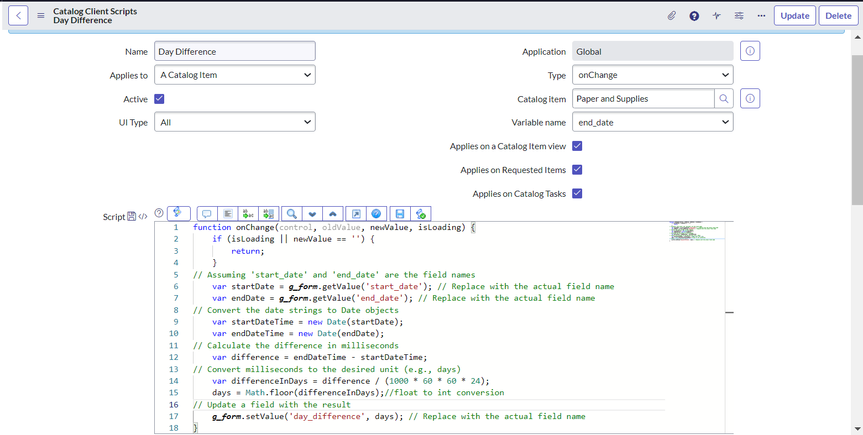

Sayali Gurav
Hello @vasu17 ,
You can try it by using client script, you can use following javascript code in your client script :
Mark helpful & correct if applicable.
Thanks & Regards,
Sayali Gurav
HI @Sayali Gurav ,
When i use above code but it's not working it is showing some invalid data, please help on this

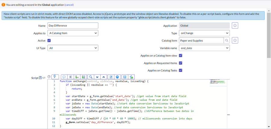

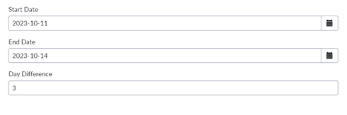

Hello @vasu17 ,
This script will helps you to solve your issue :
Compare this script with your script.
If this applicable for your case please mark correct & helpful.
Thanks & Regards,
Sayali Gurav
Hi @Sayali Gurav
Tried the same script but no luck😥
