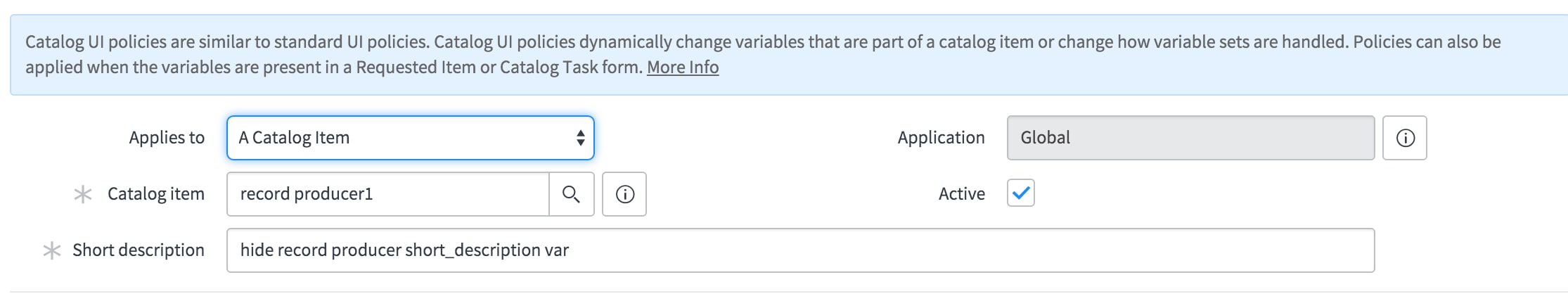

Now, if you want, you can write a Catalog UI policy to hide the variable 'short_description' containing the name of the Record producer, as:
Deepak.
