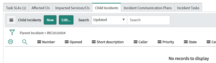

Hello all,
I have this default filter on a slush bucket, the problem is when users are editing the slush bucket, they have the ability to change the filter which could make unwanted data appear in the the bucket.
Is there anyway to limit the ability to change these filters to admins ?
Another question: how can I edit the default filter if I wanted to ?
Any help would be Appreciated

Hi Ankur,
I think there's a misunderstanding.
I believe omit filter condition has to do with the filter on the list not the one I need:
I'm talking about the filter that is inside this page:
By pressing the edit button which will open the slush bucket page where I can add/remove:
Thanks in advance
