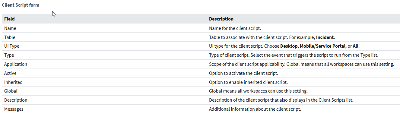

  1. Navigate to System Definition > Client Scripts.
  2. Click New.
  3. On the form, fill in the fields.
    Note: See the example configuration to configure section auto-collapse.
4. Input
g_aw.setSectionExpanded('section_name', false);
in the scripting field and modify the section name you want to auto-collapse. For example,
g_aw.setSectionExpand('related_records', false);
Note: Enter all the forms sections on separate lines to enable auto-collapse on load for all the form sections.
5.Click Submit.
