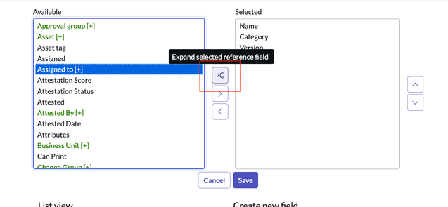

In order to implement this, simply go the the list view as show in your above image, right-click on one of the column headers. This should display a menu.
Go to 'Configure' > 'List Layout'. This will display a 'Slush Bucket'. From here you should see your 'Business App' table in green with a + icon next to it. This signifies it's a reference field and form here you can 'dot-walk' and display any of the fields on this table.
You'll also notice an icon that appears above the '>' icon. (See below image) Click on this to show the related fields and simply click on the Number field on the Left hand side to pull it through to the Right hand side.
