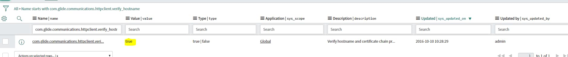

You can set the following property to false, this will cause the HTTPClient to not make the hostname verification against the ssl certificate provided.
"com.glide.communications.httpclient.verify_hostname"   to false
Hope it will solve your issue.

 org.apache.commons.httpclient.HttpException: java.security.cert.CertificateException: No subject alternative DNS name matching XXXX found.
Omkar Mone
Hi Siva,

Hi, Which menu / path I can access this form?
