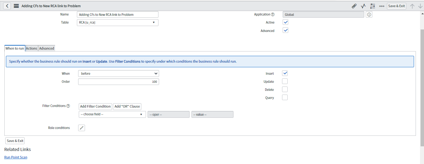

Looking at the BR looks like BR is only updating a field "u_rca " on the Table "u_causal_factors". That's it.
Now when this will be updating depend on the BR condition i.e. look in the screenshot below which will tell you how you can test it.

The above BR Script was written On RCA[u_rca] table. it was working under before insert operation and There no filter condition for this BR. But my 1st use case is here I want to Check or Test , How it is working by keeping gr_cf.update(); method in the script.
2nd use case is By block commenting (//) the gr_cf.update() method also whether it is working same like 1st use case or not?.
But My question is i am unable test this code How like it is working ?
Plz find snapshots for the reference .
