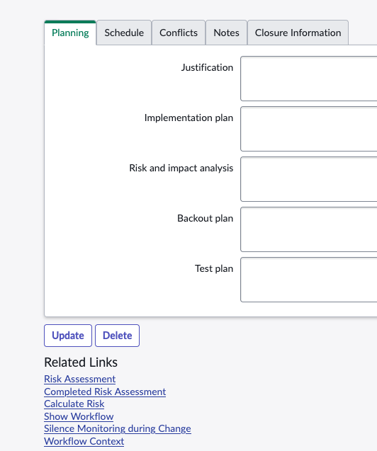

You can view a Change record, then click the Show Workflow Related Link to confirm the workflow is running, and see which activities have been completed, and which are in progress.
The workflow runs whenever a record is created on the Change Request table, it doesn't matter if this is done via a Record Producer, API, or whatever method.

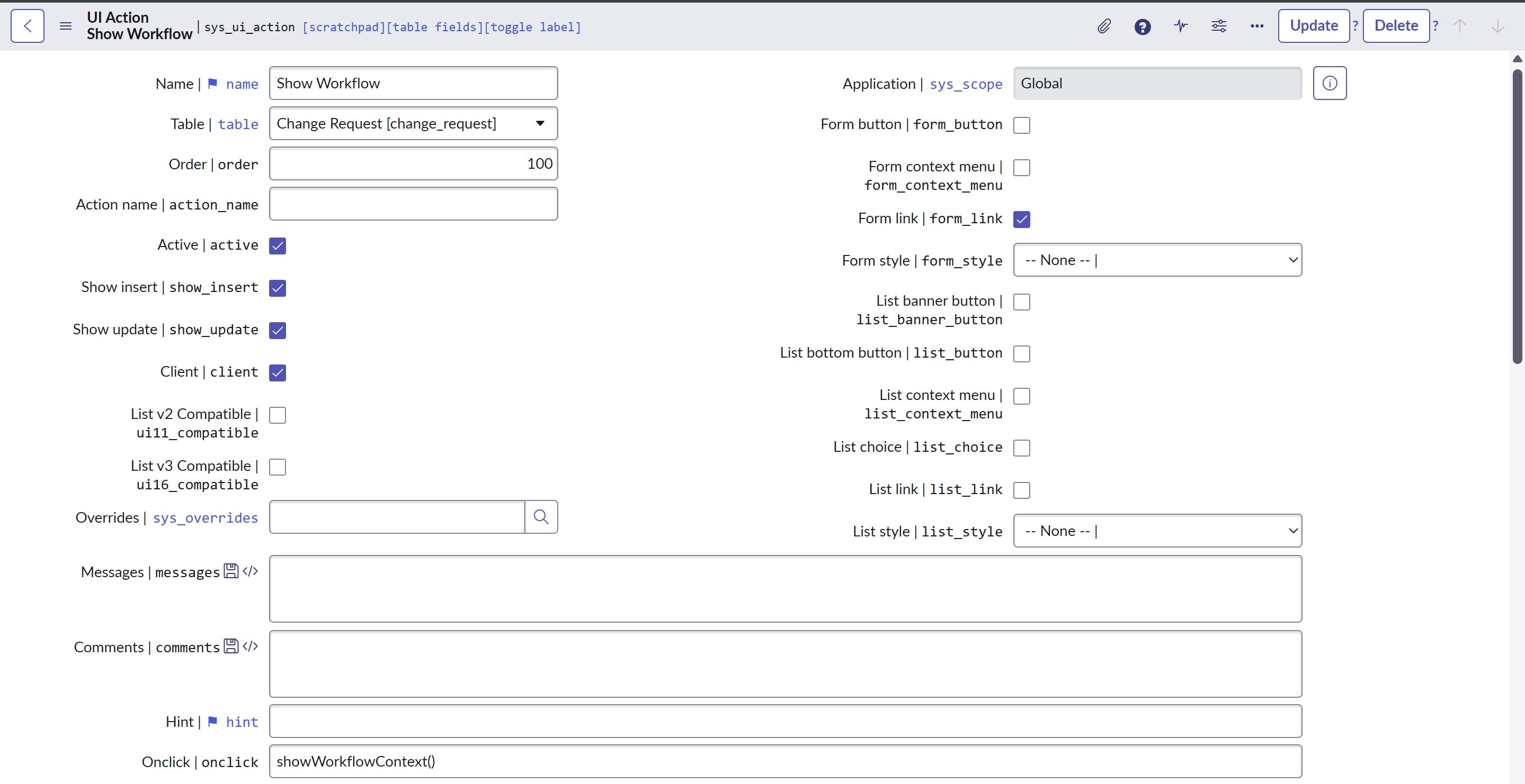

How should i enable show workflow related link
these below are my configurations
