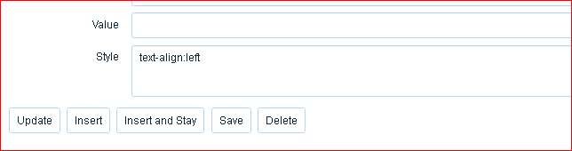

sathish639
There is no need for scripting. you just have to right click on the required integer field --> select "Configure Styles" --> add below style under Style
andrewbettc
Styles is the way to go. Tried the script first before reading on but it didn't work. It might not be the script that is at fault. Could be my execution.
However, on decimal fields, the text_align style defintely works on London
