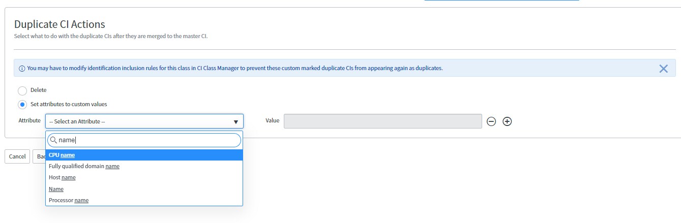

Hi Chuk,
how we are handling cmdb_ci_dns_name for Duplicate CI in De-Duplication task.
i can see, post remediation of duplicate task, its still persist in system. (merge Duplicate CI with Master CI). & during remediation task i cant see attribute here to change the state or add/update name of it, if i want to.
Thanks in advance.
Bharat
