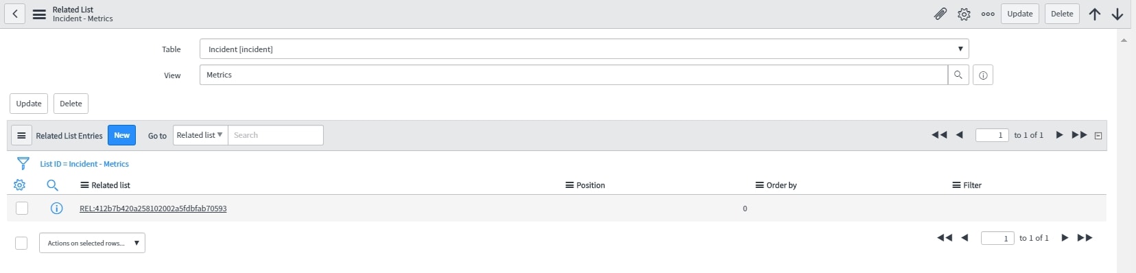

3. On the Related List table, I navigate to the Incident - Metrics entry. In that record is a Related List Entry shown below. I have not been able to figure out what that sysid is on the related list entry. I believe this is where I'm getting help up on having this list show up on other forms.
I have tried replicating this Related List Entry for the desired tables but it does not work with that same sysid, REL:412b7b420a258102002a5fdbfab70593, and because I don't what the sysid is actually for I can't fully replicate it. Screen shot of the Related List Entry is below.

Hi Michael,
This id is a sys_id of the record in relationship (sys_relationship) table, in this case its pointing to Metrics relationship. I think the table that has record in Metric Definition table will have Metrics in Related List.
In your first screenshot, Apply to script is:
var gr = new GlideRecord('metric_definition');
gr.addQuery('table', table_name);
gr.addActiveQuery();
gr.query();
answer = gr.hasNext();
Which means Metrics relationship will be available for any tables that has record in metric_definition table. The table you are trying to get Metrics on, did you checked if that table has any record in metric_definition table.
I just tested it by creating one record for Requested Item in metric_definition table and Metrics is available as Related list in sc_req_item table now.
Hope this helps.
