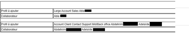

I need to send a notification from a RITM (with an email script) containing mutiple values in a List collector of a MVRS, I've got some issue.
I have a MRVS with 2 Lists collector :
In the notification, it works when only 1 user/profile is selected in each row with this code :
for (var i = 0; i < rowCount; i++) {
template.print("<tr>");
var row = mrvs.getRow(i);
template.print("<td>" + getName(row.collaborateur_test.toString(),'sys_user') + "</td>");
template.print("<td>" + getName(row.profil_test.toString(),'question_choice') + "</td>");
template.print("</tr>");
But when mutiple users or profile are selected in the same row, it doesn't work (return "Undefined", like the example below) :
Any idea ?
Ps : sorry for my bad english and my lack of knowledge in code.

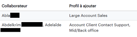

@Niels Toulorge Try this update set, I believe I have handled all type of variables here:
10-17-2025 08:45 AM
Thanks for feedback @Raghav Sharma24. The result seems a bit weird with your US :
It mixes the 2 lists Selector for one variable but not for the other.
RITM :
Notification
10-17-2025 09:08 AM
@Niels Toulorge Thats strange, it should behave same for both variables.
