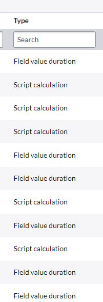

Metrics are on your instance under this metrics menu:
Specifically the metric_definition table.
Metric Definitions have two types: Field Value Durations & Script Calculations
Look at the Script Calculation versions to get a field for how they work.
