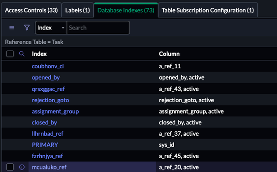

Hi @venkatesh tadip   Yes you can create an database index with multiple columns, also called a compound index. The difference between one and two column indexes would is minor. As you highlighted, ServiceNow uses them in a lot of places, including tables extending task.  Here is a screenshot of first 10 indexes on task table
