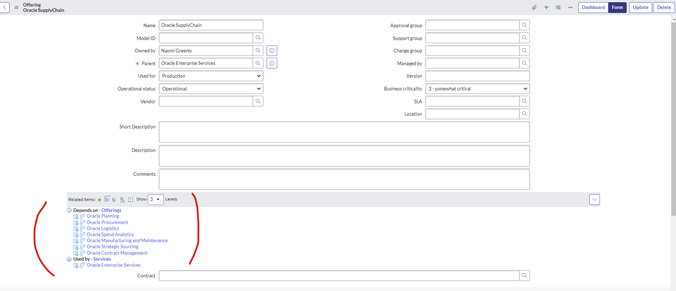

I want to create report to show the related CI's in the server table but not able to do so. need help with the same, please find the below screen-shot for the same.

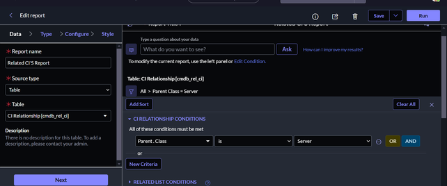

Search Reports in Application Navigator and click on Create New Report and the give Name to report and select source type as table and give table as cmdb_rel_ci.
Select report type as list and group by Parent. Add filter Parent.Class is Server and then run the report and save.

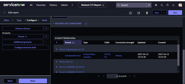

Please check the below screenshots and try same.
