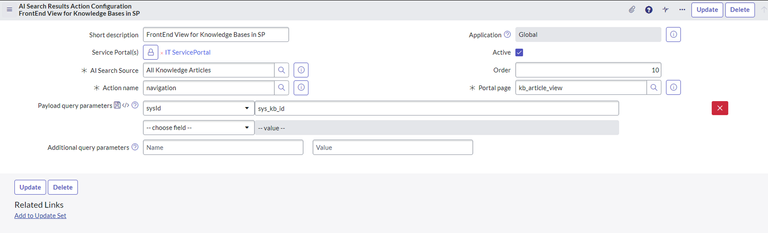

Please help me based on the issue type KB articles will display it in the portal.
Please find the below mentioned Screenshot for your reference.
Please help me out where i have configured this one.

Hi @kranthi2,
It appears that the Service Portal view is pointing to the backend view rather than the "frontend" view.
Have you employed AI Search in your instance?
Ensure to inspect the AI Search Results Action Configuration (sp_ai_search_results_action_config).
Look for Knowledge Bases, and in the 'Portal page' field, confirm that the value is set to 'kb_article_view' to appropriately direct to the frontend view.
