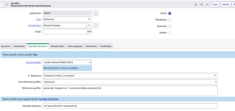

07-30-2025 05:31 AM - edited 07-30-2025 05:33 AM
@tilekarnilesh You can refer below configuration in screenshot. You need replace ": " with ":" in below line of code.
javascript: 'assigned_to=' +current.variables.requested_for
