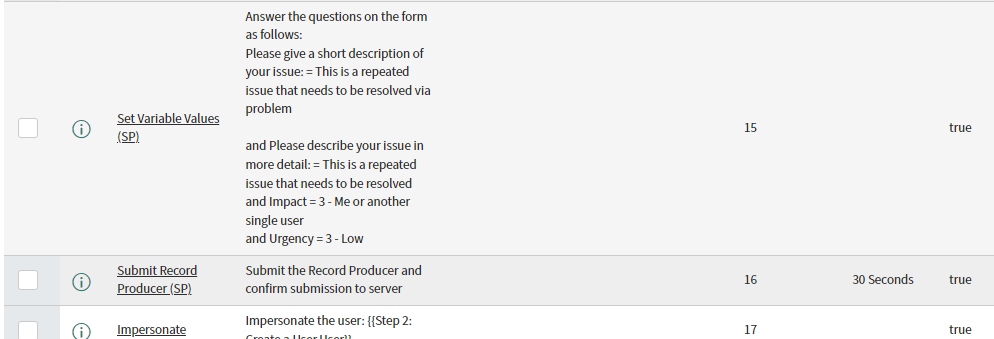

I am creating a test case for incident end to end process. I have used record producer to enter the end user information and created an incident. Then logged in as ITIL user and added more mandatory field information, It is failing at Business Service field, the error reads "FAILURE: Failed to set field 'business_service' to value '7abb1d8287710110b2bab996cebb35c7' because the reference is NOT valid". If I do exactly the same thing via Record insert, it works. I can't use Record Insert here for this case, right. Here are the steps I used to get the error. Kindly help.

Hi @Prasad Pagar ,
If you look at Step 9, I am creating Business Service it dynamically.
Suman P.
