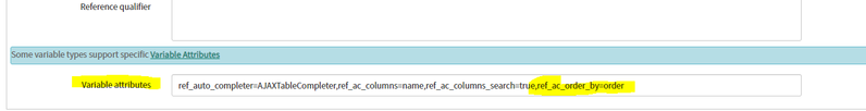

Vishal Birajdar
Hello Tariq Alshara ,
can you please try Variable attributes field on that lookup variable ?
Hope this will work for you...!!!
