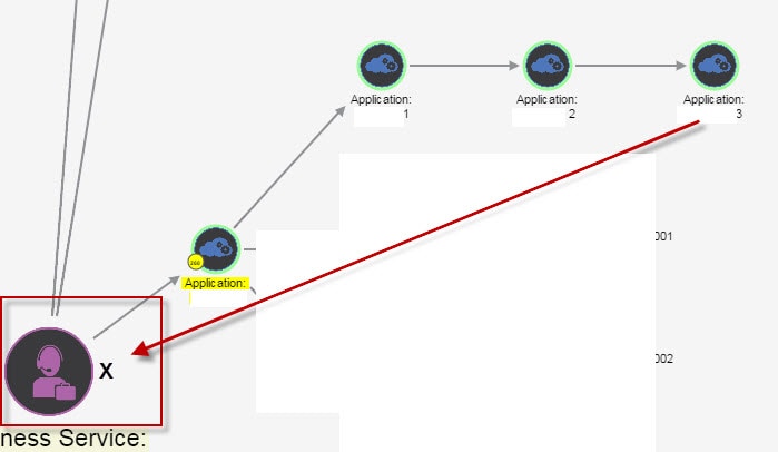

Im sorry to ask again but need help and also need to learn how to script this demand.
I can find way how to populate service on incident form if SD user select last appllication on the image below - 3
I havent luck to buil onchange client script - Im able to build script which returns me only direct relation ( from 3 to 2 ) but not what we need   ( from 3 to X)
would somebody give me a lesson here please ? Please note that I need onchange solution, so service is prefilled always when suer change CI
My system fields are
cmdb_ci   -- for apps
u_service_ci -- for service
thank you
/Petr

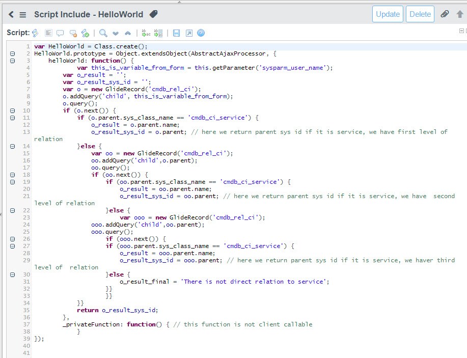

Hello, looks that I have solved it. maybe there exist better way how to write code for script include below, but it works for us and it doesnt slow down form.
If any idea how to improve script include code below, please share it with us so we and others can learn, thank you
PS: I have learned from script include on wiki, therefore i kept the same script include name - GlideAjax - ServiceNow Wiki
/Petr
Client script
Script Include
Hi Petr,
Script looks good, you will have to change the name though to something relevant.
Also, I am not expert in Ajax calls but its looks good.
Travis Toulson is an expert in this area, I had seen his community blog only to learn GlideAjax calls.
