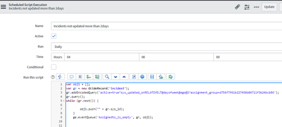

I'm able to get the list of incidents for only one particular assignment group by using encoded query as shown below. Can you please help me with the script as how to fetch list of incidents from all assignment groups? Also I need to satisfy this condition(if assigned to is empty, it should go to assignment group members, else  assigned to is not empty, it should go to assigned to and assigned to manager)
