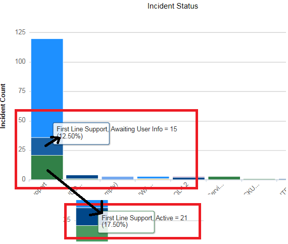

What do you think about this?

Hello John,
I don't think so you will get the report of incidents states of last month in current month.
by the report shown by troy you will get the data of incidents opened on last month but not resolved till date.
So you have to run the above report on every last day of the month to get the exact details of incidents which are opened on the same month and not solved in that month. (modify the opened condition)
also I would suggest to add stacked field on the above report to "incident state" so that your requirement of state will also get satisfied.
