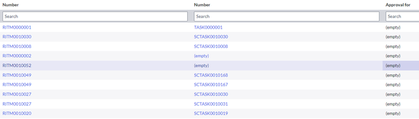

Have you utilized the right fields:
Above will give the result as shown below:

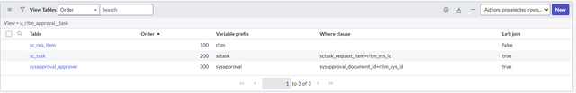

You would need to create a database view with a left join in order to get RTIMs without tasks for example. Below is a screenshot of one I created for without tasks. You would just need to add the approvals table.

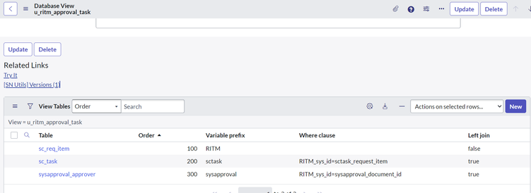

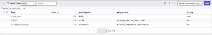

Hi @Rakesh40 ,
You need to change the order in your database view such that RITM is first where after the other table come, together with change of your where clauses:
if my answer has helped with your question, please mark my answer as accepted solution and give a thumb up.
