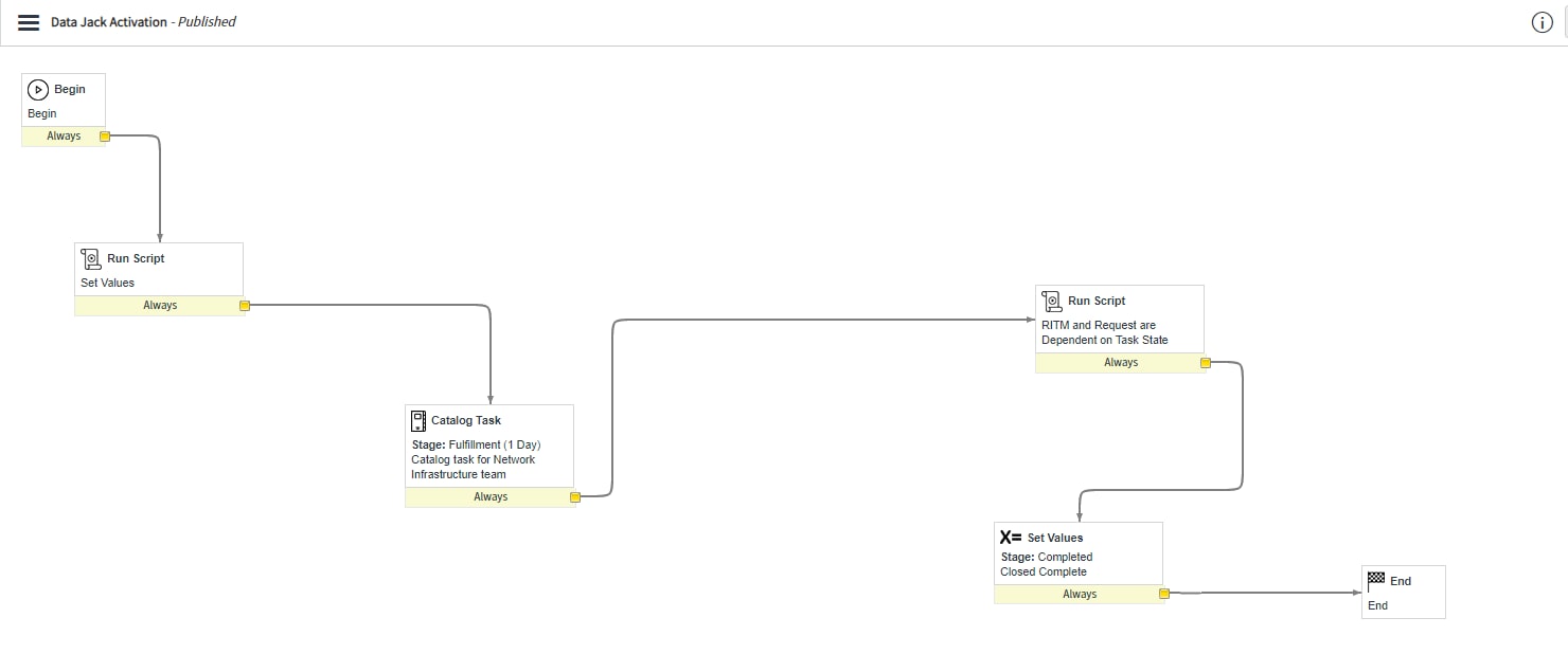

I have a requirement where the state of the RITM should be the same as the SCTask. When the SCTask is set to Closed incomplete, the RITM should show state as Closed Incomplete, if the SCTask is set to Closed Skipped, the RITM should show state as Closed Skipped, SCTask is set to Closed Complete, the RITM should show state as Closed Complete.
I have tried the workflow route and business rules route but nothing seems to be working.

‎02-10-2022 11:08 AM
Hello
After the catalog task workflow just write a if logic check the state of task and based in that have rwo set values attribute it will then move it to the one which we require

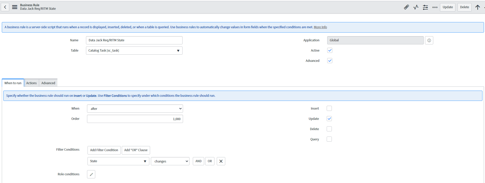

‎02-10-2022 11:13 AM
Hi
Please follow the steps below to achieve your requirement:
BR:
Table : Catalog Task
After Update
Condition of BR: State Changes;
Script:
// Add your code here
if(current.state.changes()){
updateRITMState(current.request_item,current.state);
function updateRITMState(RitmID,state){
var gr = new GlideRecord('sc_req_item');
gr.addQuery('sys_id',RitmID);
gr.query();
if(gr.next()){
gr.state = state;
gr.update();
})(current, previous);
Shloke
