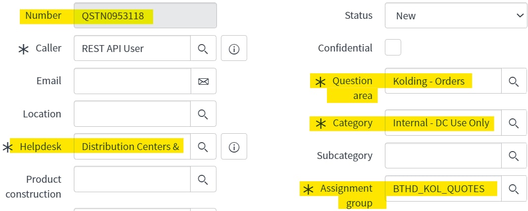

Here is our Ticket form when someone sends an email this type of Ticket get created. (by inbound action, ignore the caller field)
You can see in the above form there is field named Question Areathat record having Out of Office (checkbox) field as following, (please assume Question Area name is Kolding - Orders)
Now, here is the tricky part comes, there are several Question Areas (around 30), there is always ticket get created with different Question Area. Now we need to setup in such a way that when Owner ticked specific Question Area's Out of Office field and put the date in Starts and Ends along with Email message, then during mentioned date range Email message should be added to the notification body. And when current date reaches/equals to Ends date, then automatically Out of Office field get unticked and there will be no Email message added to the notification body. We have notification like Ticket creation(trigger when new Ticket get created)
