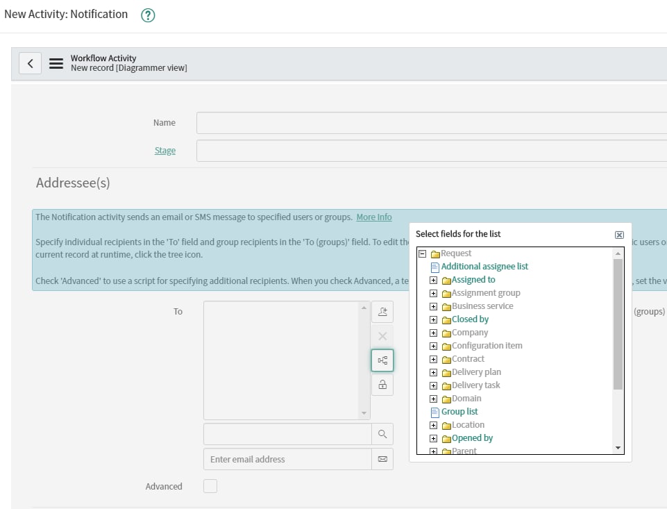

My guess is that the workflow runs on sc_req_item level and not on sc_task level. If you are trying to send the notification to sc_task.assigned_to, you would need to create a script to find the last updated sc_task for this Requested Item.
If the workflow is at sc_task level, then why are you making it more difficult? The notification activity allows you to select the field from the table.

If you have this as an activity in workflow, current.assigned_to will be empty by default as it looks for assigned_to on RITM table.
But, you said you want to send the email to the individual set as the assigned to on the catalog task, so you can create notification on sc_task table to send out after closing that particular task and send it to the Assigned To of the task.
