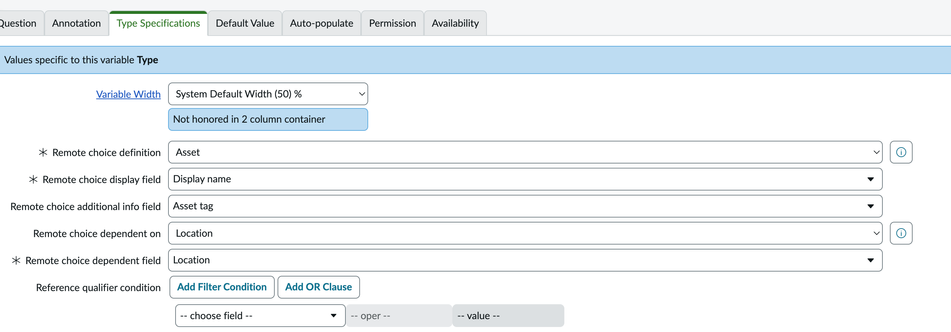

In Service Bridge, how can we use Remote Choice Dependent On at the field level in a Remote Record Producer where the field is Remote Choice–enabled?
I have Field 1, which is linked to a Remote Choice Definition, and Field 2, which is also linked to another Remote Choice Definition. Along with the filtering applied through the Remote Choice Definition, I would like to further filter Field 2 based on the value selected in Field 1 on the form.
How can I dynamically pass the selected value of Field 1 into the Reference Qualifier / Reference Condition of Field 2? Any support would be highly appreciated.

In Service Bridge, the Remote Choice Dependent On field is used to filter the available field values based on the selection made in another field.
For example, consider an Asset field for which remote choice is enabled. If you want to display only those assets that belong to a specific Location (which is also a remote choice field), you must set Remote Choice Dependent On to the Location field.
This then exposes another field called Remote Choice Dependent Field, where you need to select the corresponding field from the Asset table—in this case, the Location field of the Asset table—to establish the match.
After publishing the Remote Catalog Item, in the Consumer instance, the user first selects a location. Based on that selection, only the assets associated with the chosen location are displayed.
