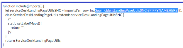

  • Go the script include SowIncidentLandingPageUtils and here we are going to update the script include name that I highlighted in the screen shot and also remove the current client script include dependencies and add our Spiffy new name one
  • Save the record
  • In the workspace refresh, and change the My Work to My Team's Work, this time you should not see any resolved incidents. If you change back to My Work, you should not see any resolved incident
