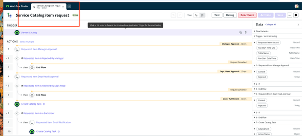

How are you setting it? Check this OOTB
https://INSTANCENAME.service-now.com/now/workflow-studio/builder%3Ftable%3Dsys_hub_flow%26sysId%3D30f3d26187e92300e0ef0cf888cb0b91
04-15-2025 09:32 AM
Hi Atul,
Thanks again for the prompt response.
Is this a flow record.? I couldn't locate it even with sys_id.. Can you please mention the name of the flow record please.?
