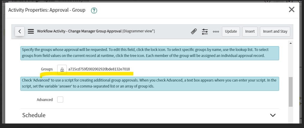

Step1: Please Open the workflow - "Standard change proposal" OOTB workflow.
Step2: Open the "Change manager group approval".
Check the approval group in case if it shows as "sys_id" of group instead of group name(like shown below screenshot), then it is due to Release or environment issue.
Step3: Please change the group with valid once and remove the sys_id. Update it and publish
Note: All the previous standard change records will not be updated because it will take the old version of workflow. So please make sure to copy it from old records and create new standard change.
