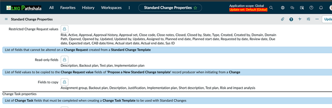

In addition to earlier details, please check standard change properties if the justification field is set as Read-Only. It could be set as per your Standard Change Request Process design.

You can go to the standard change properties, and there you’ll see if it’s marked as mandatory. Once the approver accepts it, it becomes mandatory at the change level through some backend logic.
https://INSTANCENAME.service-now.com/now/nav/ui/classic/params/target/std_change_properties.do%3Fsys_id%3D527b5dafff700200b18affffffffff89
