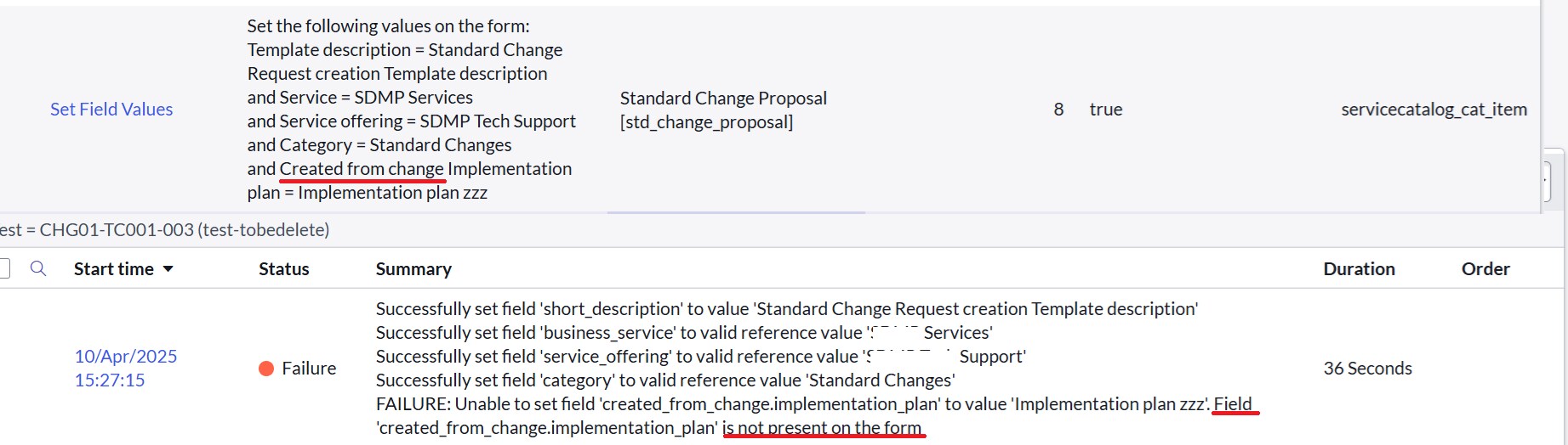

I am trying to create a standard change template and i am facing some obstacles here. Kindly help.
When looked at manual creation of template, we have short description, justification, blackout plan, risk and impact analysis etc. which are under 'change request values.
When I try to do it using ATF, I see
How should I add all the values short description, justification, blackout plan, risk and impact analysis etc. using ATF.

Hi Suman.. Thanks for the screenshot..
I tried your steps but the issue I face is, I dont see the Change Request Values drop down option under the Set Field Values .. There is an option "Created from change >> change request fields and I dot walked all the fields (impl plan, test plan, backout etc), but after running the ATF it throws an error that unable to set field "created_from_change.impl_plan to value" ..
Also in the Set Field Values I selected "Change request values" option wrote the values based on your screenshot .. After running the ATF it wasnt working.
Btw this was all under Standard Change Proposal table. This is where Im struck and looking out for assistance.

What are we missing here? Kindly advice
e__tina_khamaru
Can you please help me to set change values.
