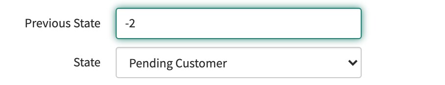

I have a field (u_previous_state) which is stores a String type value. It stores the value of the previous state.
I want to have a button, a UI Action which will change the state of my change request back to the previous state.
Here are the screenshots for the same:
Here -2 is the state value of previous state ('Scheduled' in this case)

find_real_file.pngCondition- Current state is 'Pending Customer'-> value '-50'
