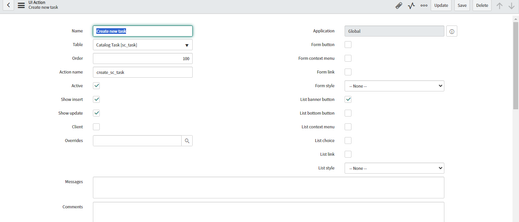

I'm trying to create a custom button to add sc task manually .But its not working.Please find the screenshot
On clicking the button, a pop up is coming showing "no records selected" and on selecting the existing task record, and then clicking "create new task " button it is duplicating everything with that of previous task.

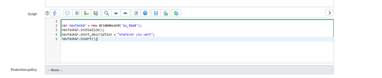

Below is the UI Action script i created on sc_task table.Please help me to correct the script so that I can seamlesly add task without any pop ups and records should not be duplicated.Atleast the SCTask number should'nt be duplicated.

Hi @Sajal Chatterje
Create UI action on RITM instead of on sc_task table and map the current record sys_id on request item field on task table. It will create manual task and automatically attached to your RITM.

Hi Sajal,
Are you sure that your custom UI action is creating duplicate task?
In your script I do not see RITM number mapping to Task field so may be some other script is there to create the task with RITM number could you please check that.
And I tried replicating same in my PDI and it is creating the task with different task number.
