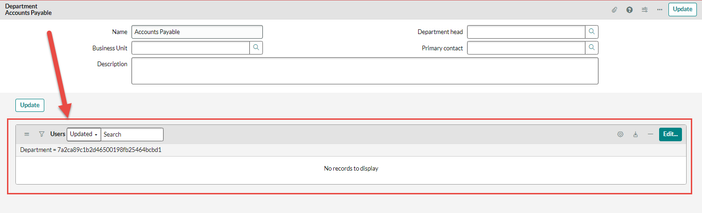

I have a requirement to update the User Related List in Department (cmn_department) with a value which is set in the User Record and vice versa.

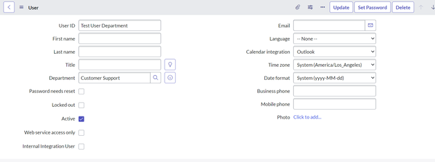

1) When I populate the Department (reference to cmn_department) record in the User Form it should update the User Related list in the Department Record (see below Department Reference in User Record):
 When this is populated I would like to update the related list in Department to show this User (see below Department record User Related List):

Hi @Wayne Miller ,
This is the out of the box behavior in servicenow:

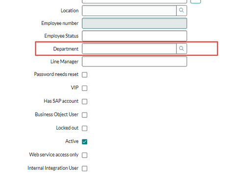

Thanks for replying.  That's great.  However, the department field within sys_user on our instance is configured as a single line text, and not a reference.
I did create a new "Department" field for user, making it a reference to (cmn_department), but this landed me back at the above.
Wayne Miller
Ok, further to this, it appears the when ServiceNow was integrated, the OOB Field designation for Department was amended.  Which on the surface seems like bad practice (create a new field surely?!)
