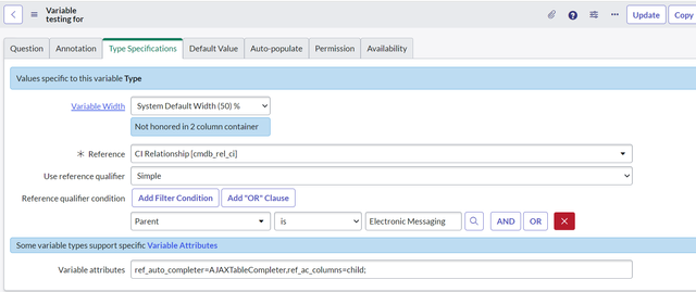

I have created a reference type of variable for a catalog item.
Here are the type specifications.
want to show the values of the field 'child' based on the filter conditions in the dropdown of this variable.

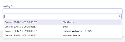

OOB it is showing as like this in portal.

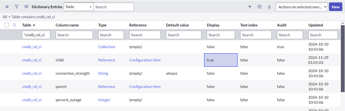

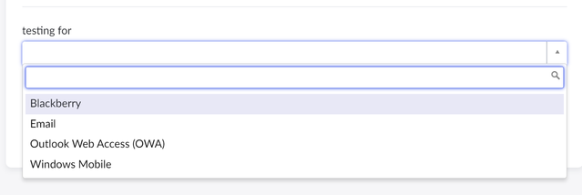

when we make the display for of field 'child' is made to true, then it is showing the choices as below.
But we want to do it without making the display as true for that field in the dictionary table.

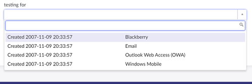

I tried with many ways in variable attribute. But it is showing the created date even if we make the variable attribute as empty.

‎12-03-2024 04:00 AM
that's not possible. Once you select it will always show field which is marked as Display=true
I won't recommend changing the Display=true on OOB table
Inform your customer about this

don't make the field Display=true as it's a platform change.
add this
ref_auto_completer=AJAXTableCompleter,ref_ac_columns=child,ref_ac_columns_search=true,ref_ac_order_by=name
‎12-01-2024 10:34 PM
Hi @Ankur Bawiskar ,
I tried by adding
still getting the same as below.
