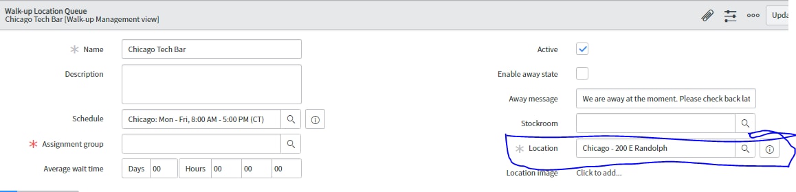

We have 3 tech bar and each tech bar location queue record have a mandatory field (Location) which is highlighted below-
So, I am thinking to write a script which filter out all the users who comes under these locations and then I will assign 'walkup_login' role to those users only from the same script.
Please let me know if there is any other better approach we can follow.
Also, if any of these users will already have some other role in ServiceNow then they will not be able to access the Walkup Portal pages. And therefore, they will not be able to Check-in Online. I am not sure whether they will also be able to check-in offline or not. Please let me know how to deal with such situations.
