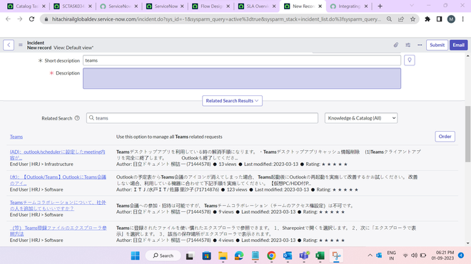

When we creating ticket in service portal, then when we fill in short description, the knowledge base related search results should show up there, how to implement that.
Like this.

Service Portal and Platform are very different in that Platform renders jelly for the contextual search Formatter/UI Macro and Service Portal doesn't since it is built on Angular JS. There is a contextual search widget, but documentation supports it as being used on record producers rather than directly on table forms.
https://support.servicenow.com/kb?id=kb_article_view&sysparm_article=KB0714564
I did try something different though to see if I could get this working using the id=form page in Service Portal.
- Formatters (like what is on the platform Incident form) can be mapped to widgets using the sp_ui_formatter table.
- Default no access to create new records for admins so need to update the create ACL to allow admins (just add admin to the list of roles)
- Add a new sp_ui_formatter record where:
- Formatter = cxs_table_search.xml
- Widget = Contextual Search - Inline Results
- This means instead of the Formatter, use the Widget when rendering in the Service Portal
Unfortunately, Contextual Search - Inline Results does not work this way, but the Formatter is correct so this is really limited to record producers.
