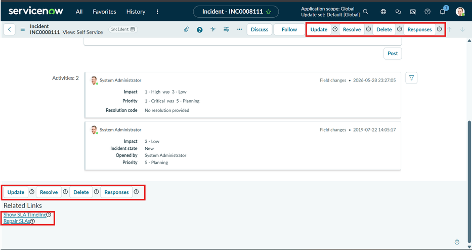

Hi @ericgilmore
If UI action (Button) is not found in your target table, check parent table of your target table.
e.g If it it not found in Incident, Check Task table's UI action. It should be there.
05-30-2026 11:40 AM
Hello @ericgilmore ,
Install the SN Utils browser extension if you don't already have it.
Open the form where the button/UI Action is visible.
Double-click anywhere on the form to activate SN Utils. This will display the backend field names and additional developer information.
Look for the ? icon that appears next to the button/UI Action. Click it to open the corresponding UI Action record directly.
If no ? icon appears beside the button, then the functionality is likely not coming from a UI Action, the functionality may be coming from somewhere else.

Hi @ericgilmore,
If the UI action is not found, it's inherited from the Parent table.
Check using through SN Utils on the form.
