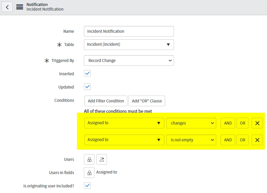

I am configuring Agent Workspace. I'd like the agents to receive a notification when an incident is assigned to them. I have set up the Notification and Notification content, but despite that, and making sure the notifications are turned on in the user settings, they still don't show up.
Following this guide:
https://docs.servicenow.com/bundle/paris-servicenow-platform/page/administer/workspace/task/configure-notification-triggers.html
Does anyone see anything wrong or think i am missing something?
Maik Skoddow
Change your conditions as marked in the following screenshot and it will work
Hi Mark,
I just made your changes as suggested and then tried taking ownership of a ticket via my lists in Agent Workspace. The notification did not come up despite the notifications for my user being turned on.. Since the originating user T/F field is checked, I should see the notification, no?
Nate
In that case you won't get a notification, as you look on the ticket. Sounds strange? Yes it is but actually working as intended. See https://docs.servicenow.com/bundle/paris-servicenow-platform/page/administer/workspace/task/configur...
"After the notification is triggered, it is sent to recipients who aren't currently looking at the target record."
Thanks Maik, I appreciate your patience, still a bit new to me. I ended up testing by logging into the mobile app as myself and then impersonating an agent on my PC and the Assigned To: rule worked fine.
