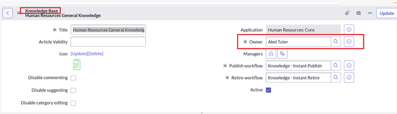

@Kohei Tominaga1   In this case, check who is the owner of the knowledge base associated with knowledge article.  Owner of knowledge base can edit the any article in present in that KB base. Owner can change the author of the article.

Anybody that is listed as owner or manager of the Knowledge Base that the article is in should be able to Edit/Publish an article even if it has been left in a draft by a different author.
