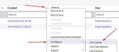

1) Configure List Layout:

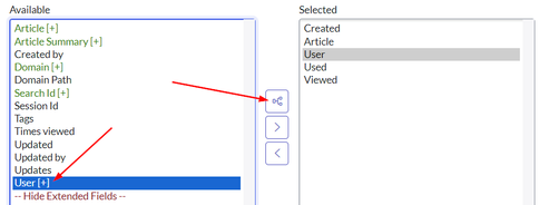

2) Then select user and the expanding option:

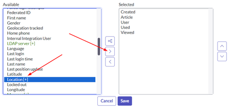

3) Select "Location" and move it to the right side, then save.
