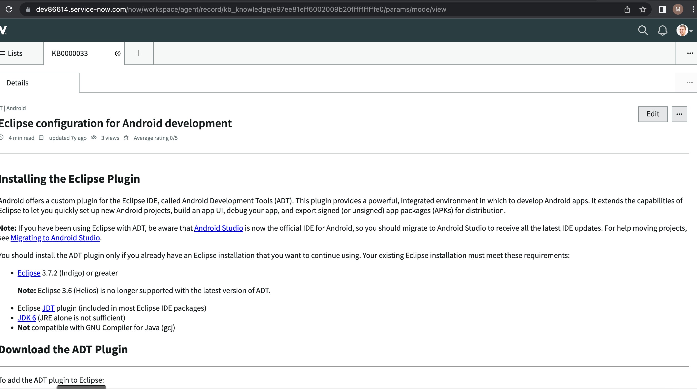

The URL for the agent workspace is different so you need to construct your link like below
"<a href='/now/workspace/agent/record/kb_knowledge/'"+your_Article_sys_id+"/params/mode/view"
this is the URL you get when knowledge article is opened in agent workspace.you can see in the below screenshot and observe the URL
