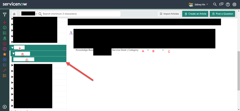

Hi ServiceNow Community,
I wonder if someone can help me understand if I am doing something wrong here. We have 5 articles that are in the knowledge base "Service Desk" under category A > B > C
Yet, when I run a search/filter for knowledge with this:
All > Knowledge base = Service Desk > Category = C
Nothing shows up. I have tried switching the Category to B, or A, no results either case. There is no way to change the category filter to be A > B > C. Can someone advise how I can filter the knowledge base to display those 5 articles that are categorized under A > B> C?

05-05-2023 12:20 PM
Thank you for your detailed response! Admins' set up the categories, but I know that there are many "C's" within other categories, so yes, there are duplicate subcategories named "C", but the "C" under category A > B is unique. Meaning there is only one category that is "A > B > C".
Per my example here:
There are Categories: X, Y, Z, A
Within A, there is a subcategory B
Within the Subcategory B, there is a Subcategory C (with the 5 knowledge articles)
There are also subcategory C's under X, Y, Z, but there is only one unique A > B> C category:
Also, I don't have the ability to use a magnifying glass to filter through the categories, which I believe, would solve my problem. Neither Category(kb_Category).Full Category nor Category fields has that capbaility. Only gives me "is" and then a field to type in the keyword.
